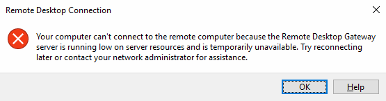

your computer can't connect to the remote computer because the remote desktop gateway server is running low on server resources and is temporarily unavailable
Is this due to idle sessions on the Remote Desktop Gateway Servers?
We think they should be able to handle far more than they are doing...

It is more likely to be the gateway where the issue is to be found as the system message appears to be reporting the Remote Desktop Gateway.
What edition of server is providing the Remote Desktop Gateway IIS?

Have a look in the registry and see if you are receiving the following error:

As the inability of the Remote Desktop Gateway server to decrypt the TLS might explain the message.
You can resolve this easily by the following:

This is a very appealing idea as the errors have only recently come to light and it has been with Windows 10 Azure connected client machines that have been causing the issue. We are seeing this error in the logs but have not successfully tied the timings to the errors as yet.
We will try and update the IIS TLS settings and report back.
Failing that, we are in the process of rolling out 2019 Remote Desktop Gateway servers which will obviously solve the issue so we may just switch over to those.
Just one question - why does it say TLS 1.0 which is supposedly enabled on Windows 2008 R2 by default and yet it does not appear in the protocols under the registry.

I have tried the registry entries, and as far as I can see it makes no difference.
The Microsoft pages say that even 2008 supports TLS 1.2
What am I doing wrong?

It will be working but in order to stop the Chrome message you need to disable the SSL 2 & 3.0 protocols that are vulnerable to the POODLE attack.
You can use this TLS/SSL vulnerability fix utility  from Nartac that will solve the issue.
We recommend using this tool on any internet facing server 2008 - 2012 R2
Check with Nartac before using it on anything newer than that.

Ah, yes, you are right. The message has now disappeared from the browsers using that site.
