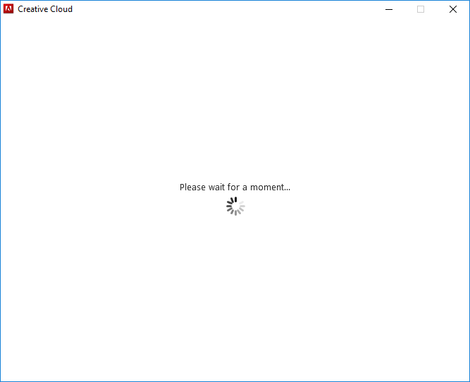

We have tried all of the advice on the adobe help pages with this including:
reinstall
removal and reinstall
remove the OOBE folder from %localappdata%
run as admin
Is there anything else we can do?
7 years ago
Here was our problem - I'm not sure how this had happened but somehow the creative cloud had started using the wrong login - we had to click the 'X' to close and then when it asked if we wanted to cancel say 'No' and then click the cancel button.
Here we could see that the wrong username was being used - why it never times out is another question...
Then there is an option to use a different Adobe ID for sign-in and so we changed the Adobe sign-in and voila!
6 years ago
Thanks for posting this solution - we were stuck with this, and the issue appears to still be the same. If the wrong user name is in the Creative Cloud settings, it just wait forever saying please wait!!
