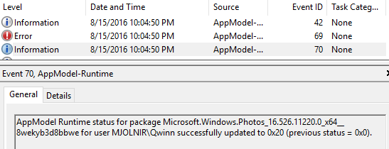

Are you getting another Event ID 70 shortly afterwards declaring a retry and then an Event ID 42 explaining that the retry was successful?
This is often the case with this error and can be a false indicator of an issue.
If you find an update that did not process within a few seconds when reties then this indicates an actual problem.
