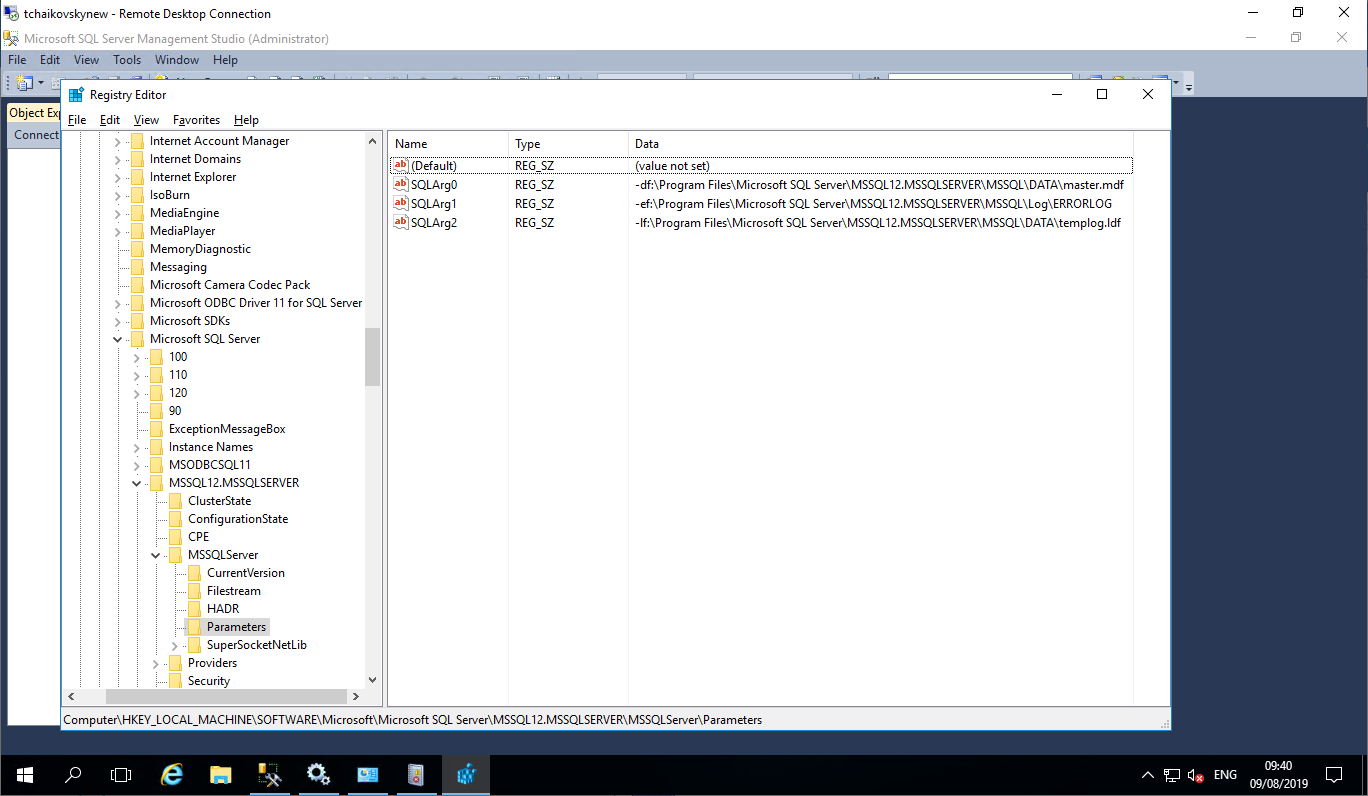

Is this a permission error or a problem with file location, I think it will amount to the same thing.
5 years ago
After jiggin' the positions of the files
(this was a restore from another SQL server)
I now have this error instead - I am pretty convinced it is just the file locations of the model and MS DBs in the registry and the model.mdf DB that are causing the issue:

This was actually due to the logfile destination under the registry here:
Windows Registry Editor Version 5.00
[HKEY_LOCAL_MACHINE\SOFTWARE\Microsoft\Microsoft SQL Server\MSSQL12.MSSQLSERVER\MSSQLServer\Parameters]
"SQLArg0"="-dF:\\Program Files\\Microsoft SQL Server\\MSSQL10_50.MSSQLSERVER\\MSSQL\\DATA\\master.mdf"
"SQLArg1"="-eF:\\Program Files\\Microsoft SQL Server\\MSSQL10_50.MSSQLSERVER\\MSSQL\\Log\\ERRORLOG"
"SQLArg2"="-lF:\\Program Files\\Microsoft SQL Server\\MSSQL10_50.MSSQLSERVER\\MSSQL\\DATA\\mastlog.ldf"
I had accidentally pointed it to the wrong drive :(
All's well that ends well 🙂
